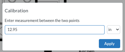

Hi,
Is possible to set measurement calibration programmaticaly ?
because I don’t see any methods to do it from LineAnnotation API docs.
 ![Screen Shot 2021-12-03 at 1.17.43 PM](https://canada1.discourse-cdn.com/flex031/uploads/pdfjscommunity/original/1X/52a2a3b600dc8eff2a6e0a1bbd0ba857e6cc73e6.png)
Thanks 😄

Hey!
See [this guide](https://www.pdftron.com/documentation/web/guides/measurement-tools/#setting-scale-and-precision-programmatically) for information on setting scale programmatically. (This is a PDFTron guide but everything is the exact same.
Let me know if you run into any issues.
Logan
