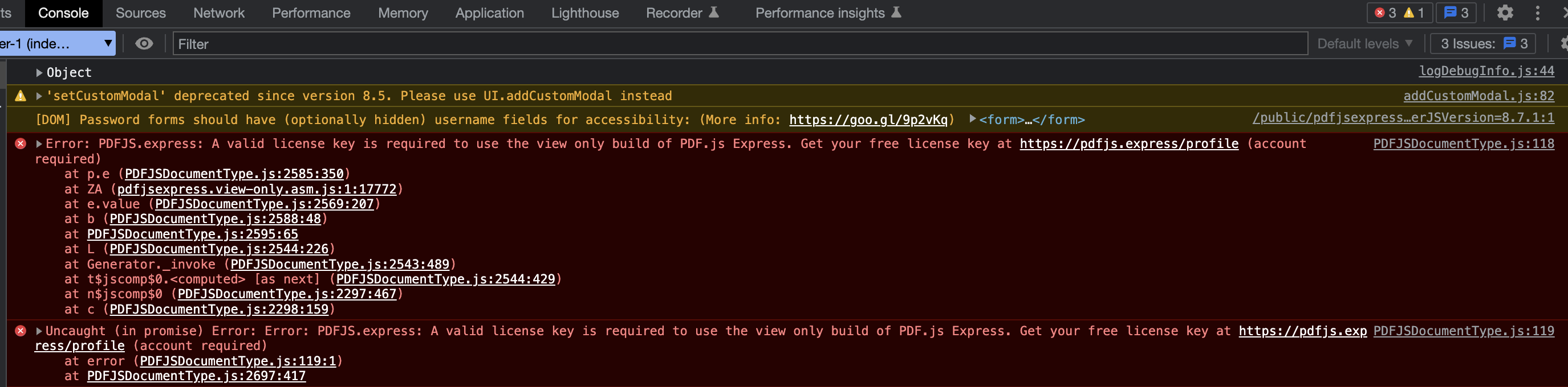

Thanks, It indeed works in an incognito window, though inconsistent, after a few refreshes, PDF stops to load and I see this error in the console. I do see the request with the license key with the 200 response in the dev tools. What it might be ?
Hi there,
Glad that worked out for you,
I tried refreshing a dozen times but was unable to reproduce your issue above. Can you please provide step by step reproduction steps?
Is this something you can possibly reproduce in the demo site?
Best regards,
Kevin Kim
Hm, now I can’t reproduce it anymore. I’ll keep an eye on it and will let you know if it happens again. Thanks for your help!
