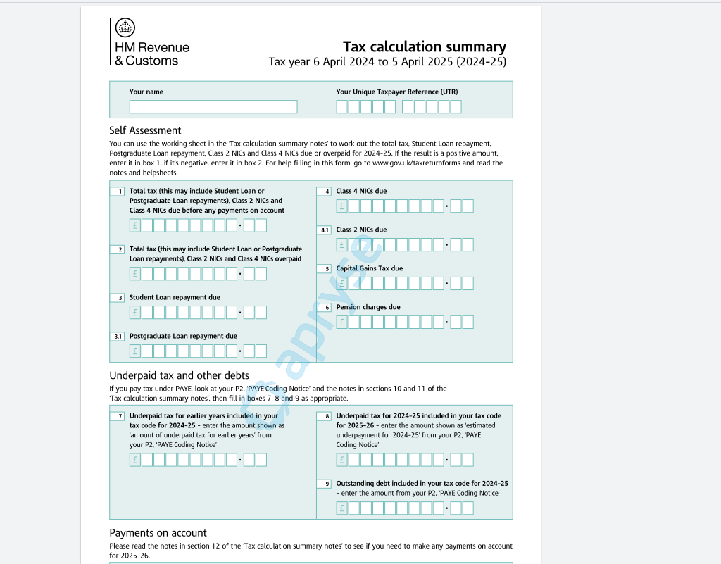

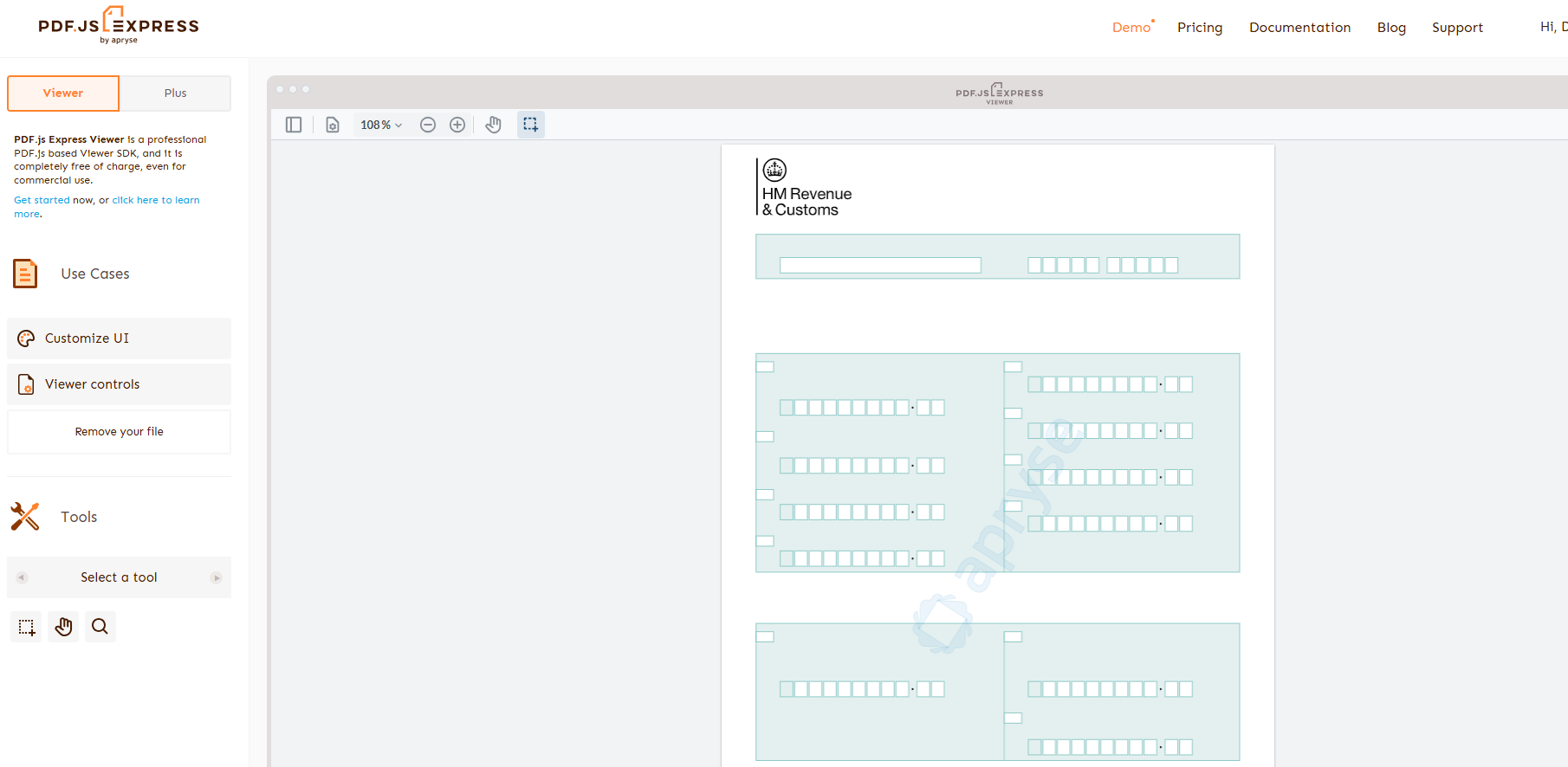

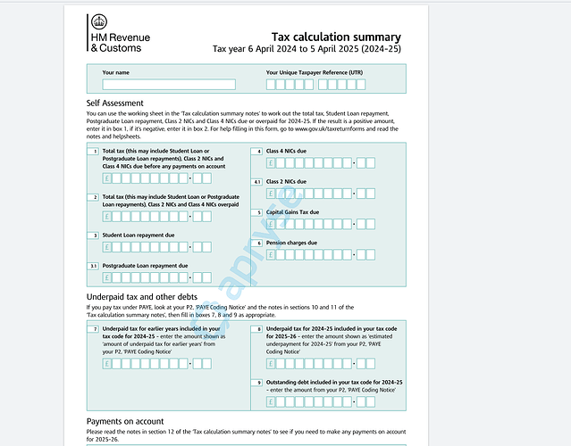

Here are the two versions - One in Apyse with correctly loaded fonts and one in PDFJS Webviewer Demo

Done using Windows 11, and both latest Chrome/Edge.
