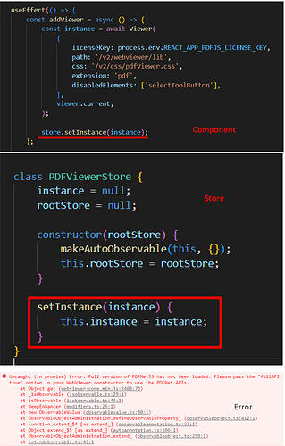

I’m using the React app with the MobX store. To have a viewer control over whole app I was trying to provide viewer instance after initialization to the store. The store for this example would be very simple, just with 1 method to set the instance and receiving next error (sorry for images, can’t upload more than 1 photo):
But I’m not able to enable full API, becaus “fullAPI” is not a valid constuctor option for PDF.js Express. I even don’t need to enable fullApi, just want to pass the instance to the store.
Without passing it to the store, it works perfectly, even though I create a class, based on this instance and pass it up to some component levels. Is there something I’m missing?
Last Note: If store is not auto observable all is working fine, but this solution is useless because components that use store can’t understand that it has received a viewer instance.

Hi @azhuravlev,
Is this happening in your local environment or on production?

Actually on both of them, I didn’t succeed to solve this.
Hi @zserviss, any update on this?
Hi @azhuravlev,
Unfortunately I do not have an update. Could you send me over a sample project so I can debug this?

Sure, provide me an email address please.

Have sent you an email 20.02.23 with a repository link with the example you asked for. Have you got a chance to look?
Hi @azhuravlev,
I have gotten the repo yes thank you.
I have not been able to figure out the issue yet but will let you know when something is found.
