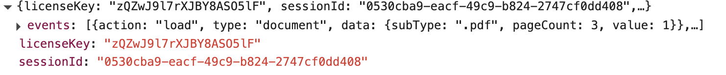

Thanks for your reply, i added a screenshot of what is visible in chrome. Also see the license key as it is shown under licenses.

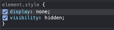

I saw that you are setting display: none on your viewer element. This could be causing an issue with the viewer. We recommend using visibility: hidden or setting the heigh and width to 0. Try removing display: none and see if that makes a difference first.
Thanks for your reply. Are you sure this is the viewer element. The only i frame i could find with this inline styling is part of googles tag manager. I also could not found any display:none regarding pdfjs. Could you clarify where you found this?
