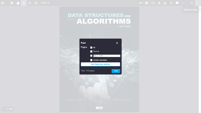

I have disabled print button on menu (three dots menu) but in full screen mode as i press cntl+p command then small print dialog box is showing.
Can i user to restrict cntl+p on on full screen mode ?
Print popup is showing on full screen.
It should not show while i have disabled print button from three dots menu.
U can check this on below given screen.
